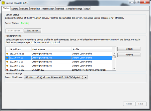

I have taken a screenshot of the profiles. Half of these do not show up on my router, not even sure what some are? I have given the TV a preferred IP but even the old one that was assigned manually is showing up in addition to the preferred. I've also reset Serviio and make sure the preferred IP's start at XXX.XXX.X.100 where if there are assigned randomly they begin at XXX.XXX.X.2 to ensure a random Ip isnt assigned if my preferred device is not ON.
I will try what you have listed and report back

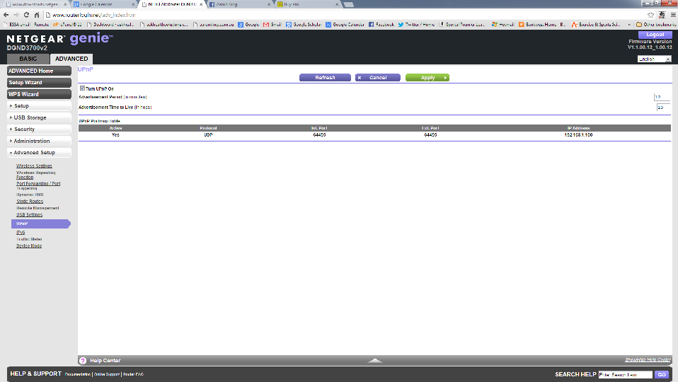

Could this be it? I've found the manual for this but still unsure what it means.
Turn UPnP On ON
Advertisement Period (in minutes) 30
Advertisement Time to Live (in hops) 4
UPnP Portmap Table
Active Protocol Int. Port Ext. Port IP Address

You can clean out all old renderer addresses if you like - Remove all of them and then press Save, press Refresh (and assign the proper profile if not automatically assigned) and then press Save again. Servio retains every IP address it ever sees, hence the list of unknown addresses. Next version will allow you to disable access for any new renderers, which will help.
Post Thu Jun 27, 2013 1:55 am
Re: service disconnects and cannot be found - E series Samsu
Only if UPnP was off previously. It should be on.
If UPnP is working and you also have "Automatically configure your router" enabled in the Remote tab, you should also have the TCP Port 23424 listed against your server address. If you don't have any ports listed it would suggest UPnP isn't working.

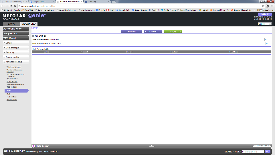

2. - UPnP was already switched on although I decreased the advertisement time and increase the TTL to cover my bases.
I don't seem to have any ports listed against it. Maybe this is an issue although I have always has UPnP ticked

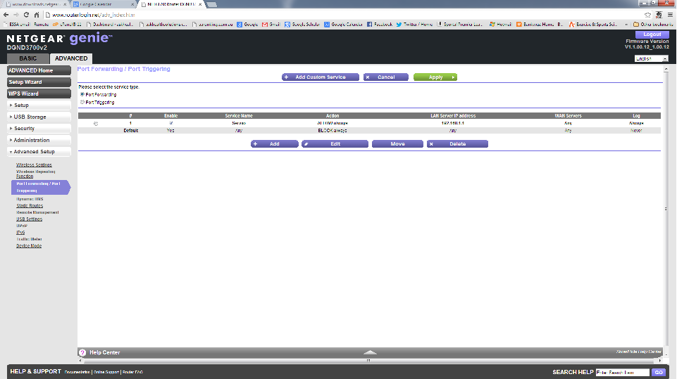

I believe I figured out how to add a port forward as you mentioned. I added the 'custom service TCP: 23424' then added my routers IP to it to allow this port through. None of the above attempts at a fix worked so I hope this does.
OK, you have exactly the same router as I do. There is no need to port forward on this router - UPNP should do this for you. As you didn't get port 23424 showing up in your UPNP list and I know this router's UPNP works, it must be your PC that is blocking it.

I screenshotted the UPNP page under advanced

I turned the firewall off and this showed up under UPNP. that IP is the PC that Serviio is on. It doesn't seem to be the TCP 23424 that it should be

No you probably won't get port 23424 unless on the evaluation or pro version as its Mediabrowser that uses this port (a pro only feature). You can tell your status on the "About Tab" - it will either show Free or Evaluation version. Suspect its on Free :-)
The fact that some other software has now opened a port via UPNP tells me your firewall is blocking these transactions (my list of ports opened under UPNP is over a page long with various software on various PC's opening ports). I'd reset the parameters in the router for UPNP back to their defaults by the way.
With the firewall disabled test to see if your TV's now see Serviio a bit better over the next day. Also, is there a rule for Serviio to accept UDP packets (I have three rules, two for Serviio Service on TCP and UDP, and one for Serviio Console on TCP - I actually have 21 rules, but its seven times the same rules by the look of it. Suspect this is all the versions I have tried so I may pass on to @zip to look into).

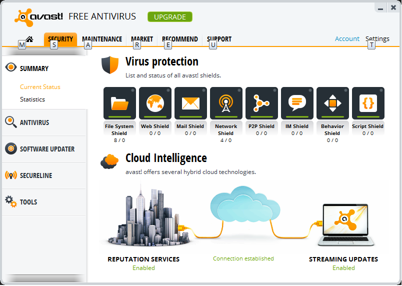

  • Avast - also may have a firewall. Make sure that is disabled for now (running two is never a good idea anyway).

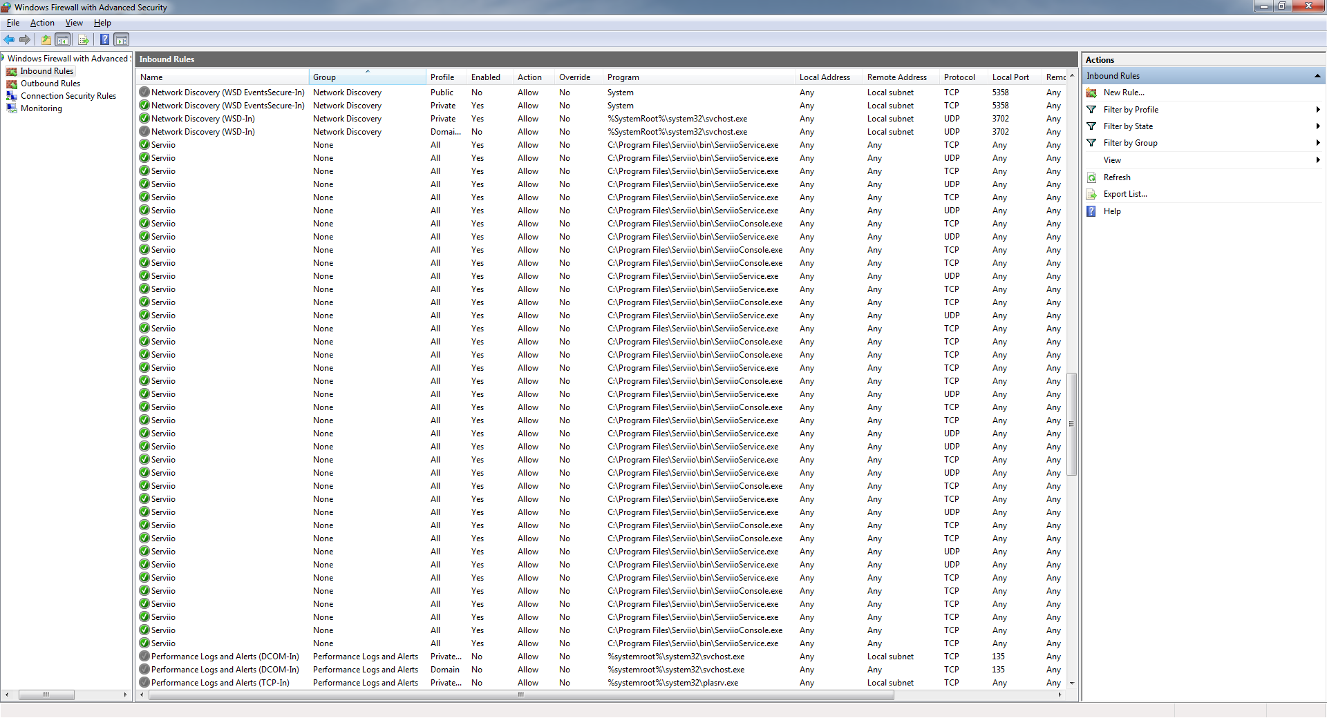

  • "Is there a way to update those exceptions to allow them through" - I think you should be able to manually create them. You need to allow both TCP (all ports) and UDP (all ports) to ServioService.exe and TCP (all ports) to ServiioConsole.exe (you need to point to the full path). I'm curious - which of these do you have now?
I'd leave the firewall disabled to try and determine whether this helps the situation. In any case establish the firewall rules ready for when we turn it back on. At this stage it may also pay to do a detailed log again to see if it has cleared any of those socket shutdowns - try and capture when the servers are and then are not showing up on the TV.

2 - I can only turn all the shields off or on, nothing between. I don't think any of these listed are a firewall. Avast has asked me in the past if I wish to upgrade and include firewall security I'm sure.
3 - Firewall rules - Ive attached the screenshot. They all seem to be allowed through.

The Network Shield in Avast looks suspiciously like a firewall :) You can see what firewalls are running by typing "Security" into your Windows Start area, Select "Check Security Status" and then expand the Security area, and the "View installed firewall programs". Basically we want them all off for now (and when this is all over, only put one back on).

  • I've always had Avast free on with the browser defender. (It says it should tell me if it's blocked something and nothing is appearing)
  • I'm also testing streaming a movie using airplayer app on my ipad from serviio to check if this cuts. Not sure if whatever it is (avast or other) should still impact on it TO the ipad
  • the computer usage data is also quite low. So it's not being stressed at all
I'm currently testing a movie with the normal firewall off to check.
Then I'll do a second test with Avast off if I'm not successful.
