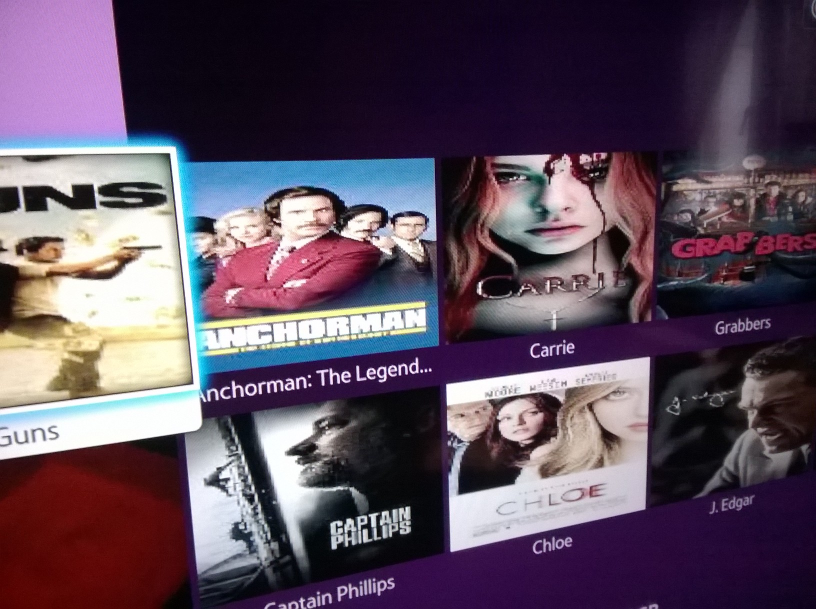

Post Sat Jan 25, 2014 11:19 am
Re: support serie F (2013)
Sorry for the late response, here is the screenshot. You can see how the thumbnails are stretched, probably the TV should check the resolution of the thumbnails and draw them with some kind of frame.
I think that serviio should create custom thumbnails for each client device, using the profile settings.
