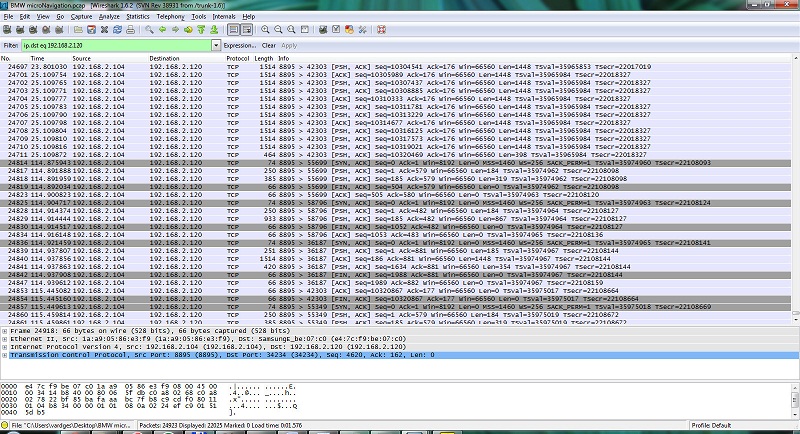

vard81
Posts: 18
Joined: Sun Oct 02, 2011 1:17 pm
Post Thu Oct 06, 2011 6:31 pm
Re: Connection drop while playing online video with Samsung
I have my PCAP file for same video that Andreas posted but I did not know where to post it. If you need it let me know I will figure out something.
Andreas is right while his TV can play that video 10 second my TV dose not play at all.

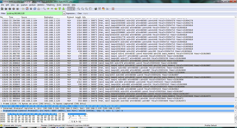

I did other experiment. I got online http://www.youtube.com/bmw#p/u/1/g9KVYlczExU video and played it and captured by Wireshark. Then copied temp file to .mp4 file and the played and captured again.
I have attached screenshots for last packets. Please look at time difference between last PSH packet and SYN one.

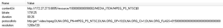

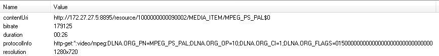

Post Sun Oct 09, 2011 7:28 pm
Hi
Here are the FPS and duration reported by ffmpeg running manually from the line in the log.
Duration: 00:00:26.30, start: 0.000000, bitrate: 1433 kb/s
Stream #0.0(und): Video: h264 (High), yuv420p, 1280x720, 1352 kb/s, 15.97 fps, 16 tbr, 1k tbn, 32 tbc
I have attached the output from AV Media Controllers Properties on the video.
Copy and playing the URL in VLC works fine and play the full video.
The video tested is the same as I tested above.
http://www.youtube.com/watch?v=OLploYLfkDk
Best Regards
/Andreas
From AV Media Controller
