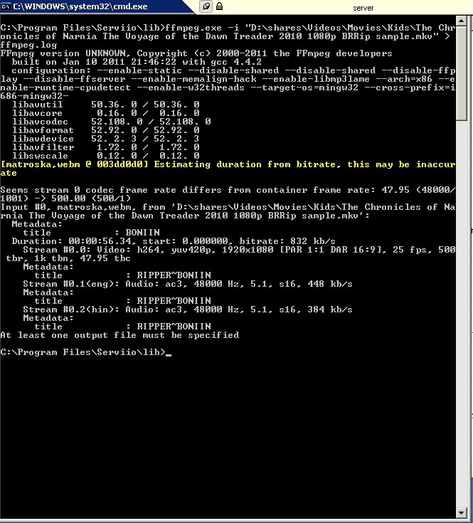

Post Fri Jul 08, 2011 1:41 pm
Re: mkv, subtitles and Samsung D - driving me crazy ...
Ok, is this the ffmpeg output needed?
schot of log
Post Fri Jul 08, 2011 2:56 pm
zip wrote: Are you using built-in profile or did you make any changes?
Can you post it here?

Post Fri Jul 08, 2011 4:21 pm
Remove this from the samsung c/d profile (not sure how it got there):
<Video targetContainer="mpegts" targetVCodec="mpeg2video">
DanL
