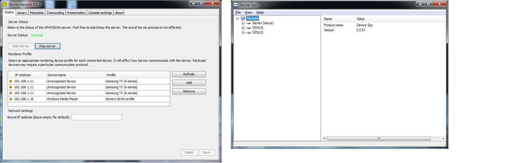

I have tried to provide the TV info, but Device Spy, newer showed the device info, see attachment.
PS: Only one TV is connected but SerViiO shows the IP 3 times, see attachment. I have selected profile, Samsung TV (A-series) hence my TV have the label LE55A, but profile (B) also seams to work the same...
