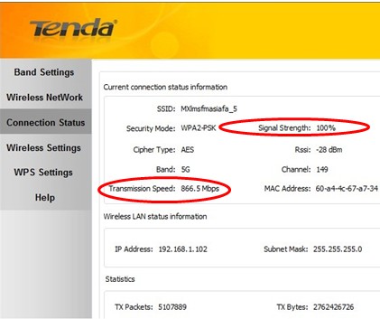

Needless to say, my networking experience with Serviio DLNA has now improved tenfold as a result. For those into the tech side of WLAN, I have since disabled my Ethernet device and I'm now using a great WLAN device from Shenzhen China from Tenda called a W900U, purchased from ebay (so cheap, I actually bought 2...). Monitoring software (works with Win8x too), is a little buggy, but the device itself is great and rock-solid. Check the stats below:
[attachment]Tenda W900U Dual Band WLAN Device (Performance Stats).jpg[/attachment]
Also getting fantastic WLAN experience in general via Dual Band Wireless Extenders that eat Ethernet for breakfast. ;)
Stats for Dual Band WLAN Device with great Serviio performance results! - Tenda W900U.
