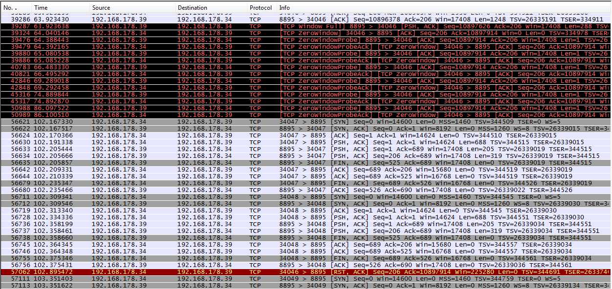

Streaming a Sopcast channel to a Samsung TV F-Series is working fine but interrupted after a couple of minutes.
From a packet trace it seems the issue starts when the TV sends a TCP Zero Window packet with length 0. I assume the TV does not understand the Zero Window Probe ACK, performs retries and a Reset is sent out 60 seconds later, then the port is closed and the connection dropped.
The trace is big and cannot be attached to this topic, see attached a screenshot.
Note. 'Samsung TV / player (C/D/E-series)' profile is set up in the Serviio Console .
Any help appreciated.
PacketTrace_Snapshot_20130630

See comments in my SOPCAST plugin thread about Samsung dropouts.
viewtopic.php?f=20&t=7249&start=60#p63628
viewtopic.php?f=20&t=7249&start=80#p65166

Thank you for your quick reply, but I need more details, I am still not sure which profile do I have to modify, profiles.xml or application-profiles.xml ?
Post Tue Jul 02, 2013 10:11 pm
Re: Interruptions during TV online streaming
Obviously the one with Samsung in it.
